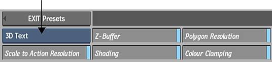

  2. From the Preset Type box, select 3D Text.
    The 3D Text Preset file browser appears, pointing to the default location of the presets: opt/Autodesk/<product home>/3d_text_presets.
  3. Optional: Enable Scale to Action Resolution to load the preset in the current Action resolution.
  4. Optional: Select which rendering settings to enable or disable in the preset (Z-Buffer, Shading, Polygon Resolution, and Colour Clamping).
    Note: These settings are enabled by default, and by disabling any of them, you may not see the intended results in the preset.
