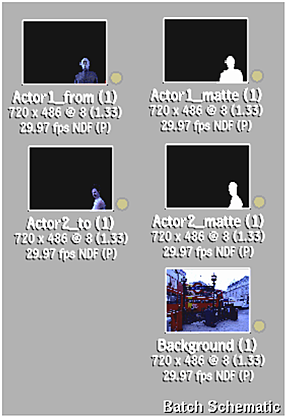

  1. In Batch, add an Front1 clip and its corresponding matte, and an Front2 clip and its corresponding matte.
  2. Add a background clip.
    Images courtesy of Behavior Communications Inc.

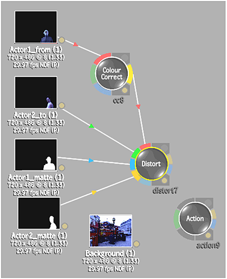

  3. Add a Distort node.
  4. Add a Colour Corrector node.
  5. Add an Action node.
  6. Connect the Front1 clip to the Colour Corrector node.
  7. Connect the Colour Corrector node to the Front1 socket of the Distort node.
  8. Connect the other clips to their corresponding sockets on the Distort node: Front2, Matte1, and Matte2. There is no background connected to the background socket since Distort will feed into media of the Action node.

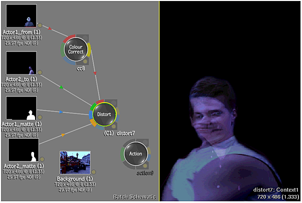

  9. Double-click the Distort node to load its controls into the work area.
  10. Create the morph between the Front1 and Front2 clips.
  11. Split the screen and create a context view for the Distort result and display it in a viewport.
  12. In the other viewport, access the result of the Colour Corrector. Create an animated colour correction for the Front1 clip to gradually transition to the colours in the Front2 clip.

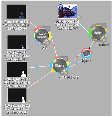

  13. In the Action node, connect a background clip to it.
  14. Within the Action node, Ctrl-click Add to add media that feeds into the Action node in the Batch schematic.
  15. Feed the Result and the ResultMatte of Distort into the front and matte of the media, in turn feeding into Action.
