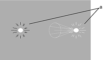

- Enable the Active button in the Light menu to activate the light source.
The light icon appears in the scene.
(a) Light sources in the scene.
