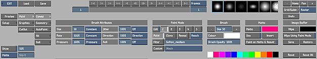

    The Paint menu appears.
  4. Access one of the following Paint menus.
    Click: To:
    Paint Use the brushes or geometric shapes to paint on the canvas, record and apply strokes to the canvas, fill areas of the image with a reference colour or image, and move the image on the canvas.
    Graphics Create, edit, and animate shapes and apply them to the canvas.
    CutOut Create and add effects to cutouts and apply them to the canvas.
    Setup Set preferences, rendering options, grid guides, and colour correction options.
