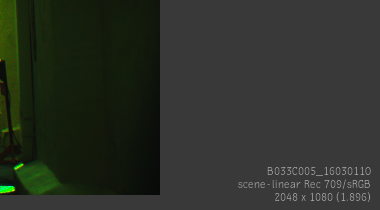

- It is shown in the lower right corner of many viewports.
However, if the clip is tagged "Unknown", the colour space is generally not shown.
