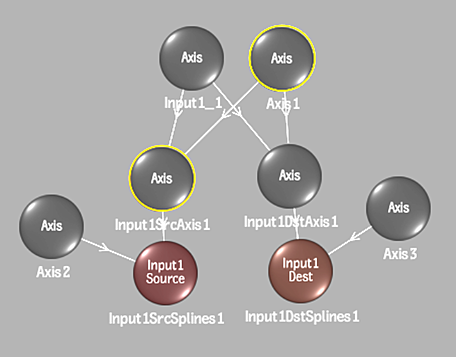

When you add multiple axes above a pair of source and destination splines, each axis can be used to manipulate a separate instance of the pair of splines. You can then use the Distort settings for each axis to manipulate the instance of each spline. In the following example, the Input1_1 and Axis1 axes can be used to change instances of the source and destination splines. Axis2 and Axis3 cannot be used in this manner, since they are only attached to one input spline.
