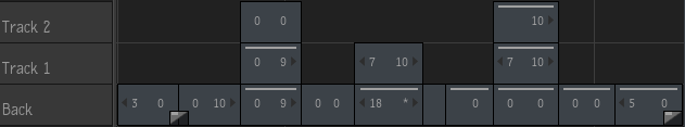

To create a shot:
- Verify that the shot has a "layered cake" structure.
This structure is the best layout when publishing a shot: Flame uses a bottom-most left-most segment part of the shot to create the shot's timing structure.
- Identify segments that are part of the shot by assigning them an identical shot name. For
Flame, a shot is a group of segments that have the same Shot Name.
You can edit the shot name from the Conform view, or with the Rename Shot option from either the Timeline gear menu or contextual menu.
- Repeat for each shot on your timeline. Make sure to assign each shot a unique name.
Tip: The Conform tab provides your with a great overview of your timeline, including assigned shot names.
Possible strategy for naming shots:
- Select the bottom video track.
- Select Rename Shot from the Timeline gear menu.
- From the Add Token, select Segment Index. This assigns a unique shot name to each segment.
- Now go from segment to segment, assigning each segment the segment id of the bottom-most segment. You can do this in Conform, to edit Shot names in bulk.

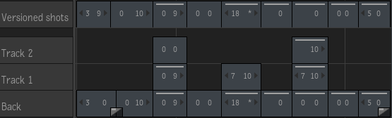

Once the export is completed, you can see, next your original sequence, the published timeline named as your sequence but appended with
_publish.
When you open a shot published sequence, the versioned shot appears on a different Version layer of the sequence. The bottom Version contains the original sequence.
The versioned shot actually contains all of the media of the shot and effects, keeping the timing from the original sequence.

- Open the published sequence.
The original sequence is displayed on the bottom Version of the timeline. A new Version contains the track with the published shots and referenced media.
