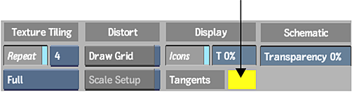

You can change the colour of tangents on the splines you draw. This is useful to better contrast the spline's tangents from the clip so that they are easier to work with.
To change the colour of tangents on splines:
  1. In the Distort menu, click Setup.
  2. In the Setup menu Display section, click the Tangents colour pot.
  3. From the colour picker that appears, select a colour.
    Tangents are displayed in the colour you set.
    Note: All spline tangents are initially displayed in magenta after they are drawn until a source spline and its corresponding destination spline are offset from one another.
