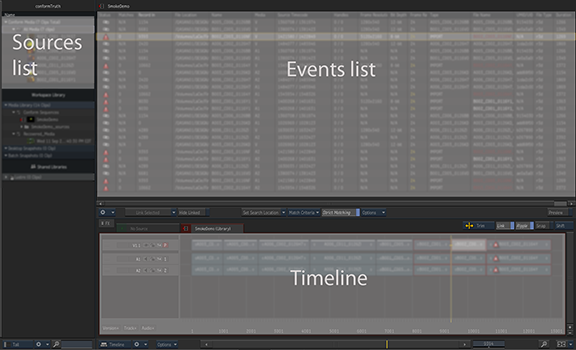

Events List
Displays the events that make up the sequence displayed in the Timeline area. Selecting an event in the list also selects it in the Timeline. You can sort the list using by clicking the column headers. Linked events are usually displayed, but if you are only interested in unlinked events, you can hide the linked events from the Display Options box. If the Events list displays the message All Sources Linked, the selected sequence is already conformed.

Sources list
The Sources list display all the information about the sources found when using Set Search Location or Set as Conform Search Location, from the contextual menu. From all the potential sources, Flame uses the criteria you set using the Match Criteria box to filter in potential matches. From there, you can select the right source and link it to the selected event.
Disable Display Options > Filter Potential Matches to show all the sources. If you select an event with no matches, it shows the full list, in order to allow for force linking.
In the Media Panel, click the Conform tab to display only the Sources list.
Timeline
The Timeline displays an open sequence, with controls similar to the ones found in the Timeline tab. Unlinked segments are boxed in red.
