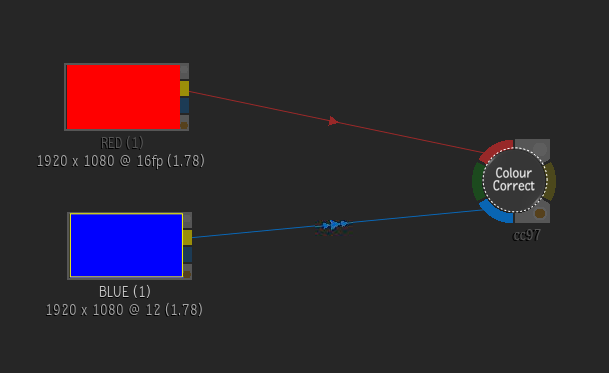

Enable Show Adaptors in the Batch or Batch FX preferences menu. You can see that an adaptor has been applied by an arrow inside two smaller arrows on the link between nodes in the schematic. By hovering over the adaptor, the applied conversion is displayed in a text box, much in the same way as tooltips (i.e. [12-bit u -> 16-bit fp]).
