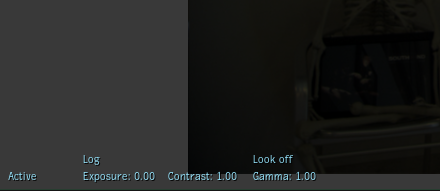

To modify exposure and contrast interactively in an image window
  1. Click in an image window to make it active.
  2. Do any of the following:
    • Press and hold Shift+E while clicking and dragging the mouse to modify the exposure offset (overall brightness). Dragging to the right increases values and dragging to the left decreases them.
    • Press and hold Shift+C while clicking and dragging the mouse to modify the contrast between light and dark colours.
    • Press and hold Shift+W while clicking and dragging the mouse to modify the gamma.
    • Click Reset to restore the default values.
    • Press Ctrl+Shift+~ to temporarily bypass these adjustments.
To modify exposure, contrast, and gamma using the Image Display settings
  1. Access the Image Display Viewer settings.
  2. Do either of the following:
    • Edit the Exposure slider to modify overall brightness.
    • Edit the Contrast slider to modify the contrast between light and dark colours.
    • Edit the Gamma slider to modify highlight and shadow contrast.
