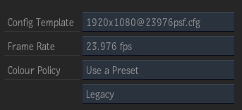

Selecting a Colour Policy when you Create a Project
When creating a project, you can select one of the example Colour Policies shipped with the application, use a policy you've previously exported, or copy the policy from one of the listed projects.
Colour Policy Mode button
Select "Use a Preset" to configure colour management settings using a policy selected from the menu below. Select "Copy from another Project" to copy the colour management settings from the selected project.
Colour Policy List menu
Initialize the colour management settings from one of these presets or copy the settings from another project.
