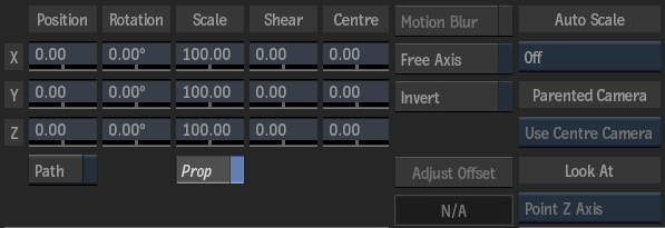

When accessing Action as a Timeline FX, you have access to a quick menu with some of these Axis settings. To see the full Axis menu, click the Editor button to enter Action.
Axis Tab
- X Position field
- Displays the position of the X axis. Editable.
- Y Position field
- Displays the position of the Y axis. Editable.
- Z Position field
- Displays the position of the Z axis. Editable.
- Motion Path button
- Enable to animate the position of the axis using a spline drawn in the scene. Disable to animate the position of the axis using explicit animation.
- X Rotation field
- Displays the rotation of the X axis. Editable.
- Y Rotation field
- Displays the rotation of the Y axis. Editable.
- Z Rotation field
- Displays the rotation of the Z axis. Editable.
- X Scale field
- Displays the scale of the X axis. Editable.
- Y Scale field
- Displays the scale of the Y axis. Editable.
- Z Scale field
- Displays the scale of the Z axis. Editable.
- Proportional button
- Enable to change the fields proportionally.
- X Shear field
- Displays the shear of the X axis. Editable.
- Y Shear field
- Displays the shear of the Y axis. Editable.
- Z Shear field
- Displays the shear of the Z axis. Editable.
- X Centre field
- Displays the centre of the X axis. Editable.
- Y Centre field
- Displays the centre of the Y axis. Editable.
- Z Centre field
- Displays the centre of the Z axis. Editable.
- Motion Blur button
- Enable to use a motion blur effect for the selected axis (can only be used once the global Motion Blur is enabled in the Setup menu).
- Free Axis button
- Enable to ignore transformations from parent axes.
- Invert button
- Enable to invert numerical Axis menu settings. This does not affect settings of nodes connected to the Axis.
- Adjust Offset button
- Enable to set the current frame as a reference frame that has no transformation data.
- Reference Frame field
- Displays the frame number of the reference frame that has no transformation data. Non-editable.
- Autoscale option box
- Select whether to autoscale when Position settings are changed relative to the camera (On Position Changes), or when Position, Rotation, Shear, or Centre settings are changed (On All Transforms).
| Select:
To:
| Off
Not use autoscaling on the image.
| On Position Changes
Preserve the projected size of the image by automatically scaling when changing any Position parameters that affect the depth of the image relative to the camera.
| On All Transforms
Preserve the projected size of the image by automatically changing Position, Scale, and Centre parameters (when any Position, Rotation, Shear, or Centre parameters are changed).
- Parented Camera box
- Select which camera is used for the parenting offset when the immediate parent is a stereo camera. Choose left, right, or center camera. Active only when there is exactly one parent that is a stereo camera, or if a look-at connection is attached between the axis and the stereo camera.
- Point Axis box
- Select which axis is pointed to the attached look-at object. Available only when objects are attached with a Look At connection.
See
Applying Look-At Connections.
