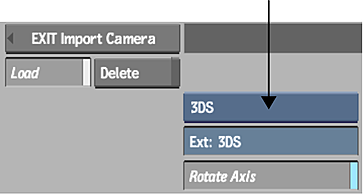

An alternative to animating a camera's position is to import a camera animation from 3ds Max. 3ds Max camera animation can be saved as a . 3DS or .ase (ASCII Scene Export) file in your scene. While the .ase format contains only a camera's positional data, the .3DS format contains the camera's position, point of interest, roll and field of view values.
Once the camera is imported, you can edit any of the camera's values and, if necessary, export it back to 3ds Max in its native 3DS format using the Camera menu.
To import a 3ds Max camera:
The Import Camera file browser appears.
You return to Action and the imported camera is applied to your scene.
