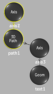

  3. Parent the 3D Path node to another object in your schematic, such as a Light node or a 3D Text node. The 3D path becomes part of the transformation hierarchy of the attached object.
    3D Path node parented to a 3D Text node
