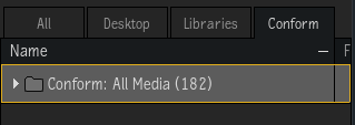

- In Conform, select a folder, a library,
a reel, or a shared library.
- Right-click and select Set As Conform Search Location.
Flame Assist clears previous sources from the Conform Media folder, and then displays all the media files from the selected location, including any media files located in sub-directories.
You can also manually add clips from the Media Panel to the Conform Media folder: drag-and-drop them to the Conform Media folder. This does not clear already present sources.
Tip: Clip the top-left Conform tab for the Media Panel to display only the sources.
