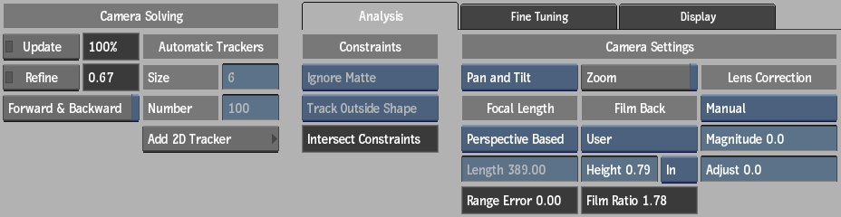

Tracking using the Analyzer Node
Perform Camera Tracking in the Analyzer menu.
Optional steps:
Fine-Tune and recalibrate or refine the camera tracking analysis. This step is optional depending on the results of your initial analysis.

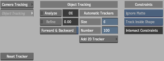

Perform Object Tracking. If needed, after camera tracking, you can track moving objects in the scene.
