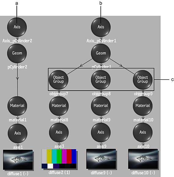

FBX models are created with one or more faces, which leads to different representations in Action.
A model with a single face appears as a simple model, with a single Material node attached to the Geom node.
A model with multiple faces appears as a complex schematic where one Object Group node is created for each face. To each Object Group node is then attached the Material node. Having multiple Object Nodes allows you to modify, even replace, the textures applied to each shader.
You cannot create new Object Group nodes, and their link to the Geom node is unbreakable; they have no editable attributes. Object Group nodes details how faces were applied to the FBX model, and allow you to texture differently the components of the FBX model.
In the following examples, one imported FBX model has a single face, while the other has three faces, one for each sides of the cylinder.
(a) FBX model with a single face (b) FBX model with multiple faces (c) Added Object Group nodes, one for each face

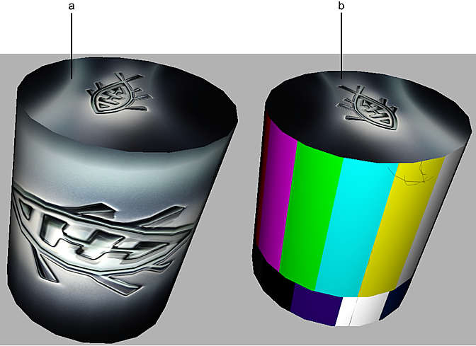

The schematic above creates the image below. Note how having different Object Group nodes allows you to link different textures.
(a) FBX model with a single face: one texture map for the whole model (b) FBX model with multiple faces: a different texture for each face
