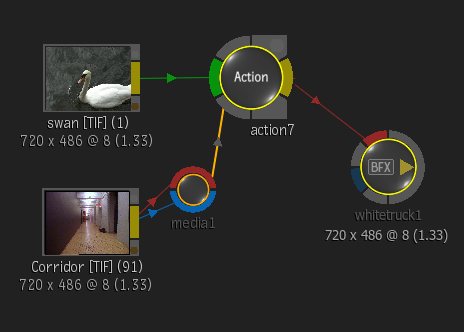

Indirect media is connected directly to an Action Media node and appears in the Batch FX schematic. With indirect media, you can connect any source (such as images, or the output of another node in the Batch FX process tree) to an Action node. Media nodes are permanently parented to the Action node (you cannot sever the process lines). You can add multiple Media nodes to an Action node.
Direct media appears directly inside an Action node, and in the Batch FX Sources folder in the Workspace Media panel, as well as in the Batch FX Timing View. Although direct media does not appear in the Batch FX schematic, media and all related settings are saved with the Batch FX setup.
The following example displays indirect media in Action. The swan clip is attached to the Action node as the back clip, whereas the Corridor clip is attached to an Action media node as the front and matte media.
