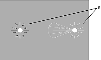

  3. Enable the Active button in the Light menu to activate the light source.
    The light icon appears in the scene.
    (a) Light sources in the scene.  
