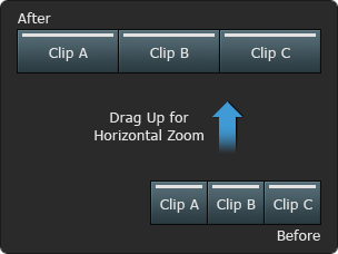

Horizontal scroll bar
To pan, drag left or right. To zoom the timeline, drag up or down.
Horizontal Zoom

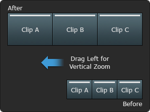

Vertical scroll bar
To pan, drag up or down. To zoom the timeline, drag left or right.
Vertical Zoom
