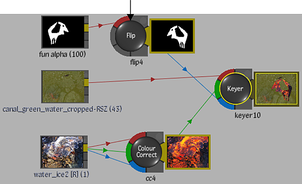

You can improve your workflow in Batch FX by deactivating certain nodes and rendering only the nodes that you want to process right away.
For any node, you can pass the Front, Back, Matte, or Key-in clip—depending on the type of node you select and its source tab inputs—as the input to the next node in a branch. If you bypass a node with multiple outputs (such as Action and Modular Keyer), the matte output will be the same as the result output (depending on the current selection in the Bypass box).
To bypass a node input:

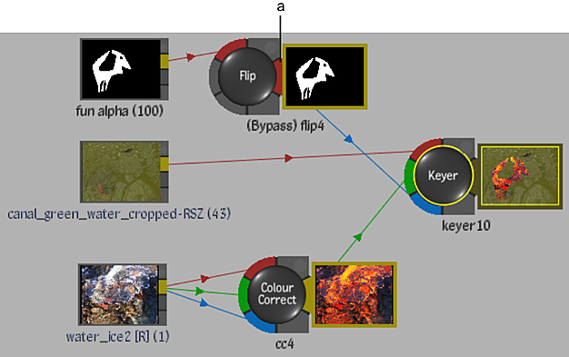

The Bypass box becomes active.
The output tab of the bypass node changes colour. In the following example, the tab turns red indicating that the Front input is passed to the next node in the tree. As well “(Bypass)” is added to the node name.
(a) Output tab of bypassed Front input
