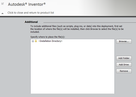

Adding iLogic configurations to deployments
You can deploy iLogic configuration options as part of an Inventor deployment:
  1. In the Advanced iLogic Configuration dialog box, select Export.
    The options are exported to C:\Users\[your user name]\AppData\Local\Autodesk\Inventor 2017\iLogicPreferences\ iLogicOptions.xml
  2. In the Inventor deployment wizard, add the file to the deployment using Additional Files:
    1. Click Add Folder, and create a new folder called iLogicPreferences.
    2. Click Browse and browse to C:\Users\[your user name]\AppData\Local\Autodesk\Inventor 2017\iLogicPreferences\ iLogicOptions.xml to add the file.
