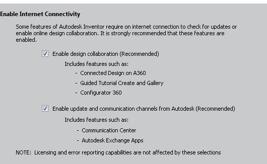

To Disable Online Collaboration and Autodesk Updates from within Inventor
  1. On the Autodesk Inventor Installer Create Deployment Configure page, click the triangle next to Click to open and configure.
  2. Scroll down to Enable Internet Connectivity. By default, access to these features is enabled.
    • Deselect the Enable design collaboration to block access to the following features within Inventor:
      • Connected Design on A360 workflows.
      • Downloading new Guided Tutorials, creating, publishing and sharing your own Guided Tutorials.
      • Configurator 360.
      Important: To modify this option, you must recreate the deployment, ensure the Enable design collaboration checkbox is selected, and then redeploy.
    • Deselect Enable update and communication channels from Autodesk to block access to:
      • The Autodesk Communication Center, which controls the following:
        • Software updates.
        • Subscription announcements.
        • RSS feeds.
        • Other product updates.
      Attention: You can always manage updates from the Communication Center using the stand-alone CAD Manager Tool, available from Install Tools and Utilities on the Inventor installer .
    • Autodesk Exchange App website
      Note: Autodesk Exchange Apps is an online resource where you can browse and purchase Apps (including product-specific content such as blocks, models, training materials, and eBooks) – and is available to several Autodesk Products. You can also prevent users from accessing the Autodesk Exchange Apps website by restricting access to http://apps.exchange.autodesk.com/ in your company’s browser. Click here to learn more about Autodesk Exchange Apps.
    • Important: To modify your access to Autodesk Exchange Apps, you must recreate the deployment, ensure the Enable update and communication channels from Autodesk checkbox is selected, and then redeploy. If you want access to Autodesk Exchange Apps, and not to Communication Center, you must manage access to Communication Center using the CAD Manager Tool.
