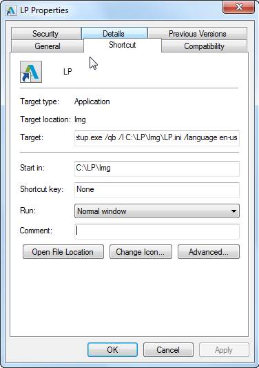

  2. Create one or more Inventor Language Pack deployments using the Language Pack installer.
Language Packs for Autodesk Inventor and LT are not on the product media. Language Pack installers are available for download from: The target line from the language pack deployment shortcut can easily be appended to a deployment script in most network management tools such as Microsoft’s SCCM. This can enable unattended and efficient multi-language Inventor deployments in even the largest enterprise networks
