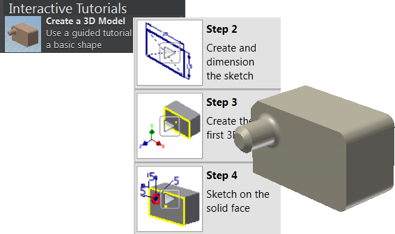

Basic skills interactive tutorial
A new basic skills interactive tutorial steps you through the commands and workflows for creating 3D objects in Inventor.
