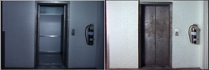

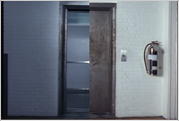

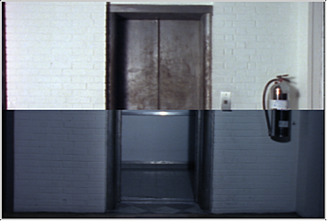

The two images displayed in Dual view are the current frames on Playheads A and B. Dual view is useful for matching two shots or for copying colour correction parameters from one shot to another. You can view images side by side, or use a wipe. With a wipe (i.e., horizontal or vertical), you see a portion of each image. You can control the position of the wipe bar by adjusting the Value slider.
