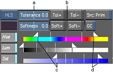

To set the softness of a key, you can use the colour picker, the Master Softness slider, or the Softness Range indicators. With the colour picker and the Master Softness slider, you set the softness range for hue, luminance, and saturation together. With the Softness Range indicators, you set the softness range for hue, luminance, and saturation individually.
(a) Master Softness slider (b) Add Softness/Remove Softness buttons (c) Minimum Softness Range indicators (d) Maximum Softness Range indicators
