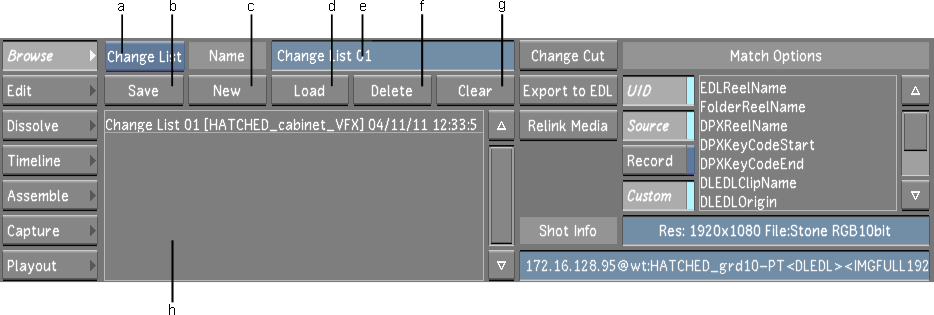

To create a change list:
The Change List controls appear.
(a) Cut/Change List option box (b) Save button (c) New button (d) Load button (e) Change List Name field (f) Delete button (g) Clear button (h) Change List Name list
A change list is created. You can see the name of the parent cut in parentheses next to the change list name.
