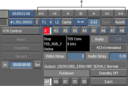

(a) VTR transport controls  

    • If performing capture operations in the Capture menu, click the Source Timecode field. The capture controls turn blue to indicate that you can use them as VTR transport controls.
    • If performing playout operations in the Playout menu, click the Source Timecode field. The playback controls turn blue to indicate that you can use them as VTR transport controls.
      Note: In the Playout menu, you can toggle between the timeline and VTR by clicking on the Source Timecode field. If the Source Timecode field is blue, the controls can be used as VTR transport controls. If the controls are white, they are timeline controls.
    (a) Source Timecode field  
    The transport controls are as follows.
    Click: To:
    Fast rewind.
    Cue to TC In. Right-click to jog back one frame.
    Play in reverse.
    Stop the VTR.
    Play forward.
    Cue to TC Out. Right-click to jog ahead one frame.
    Fast forward.
