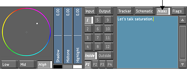

To use the Notes window:
  1. Enable the Notes button.
    This displays the Notes window below the Notes button.
