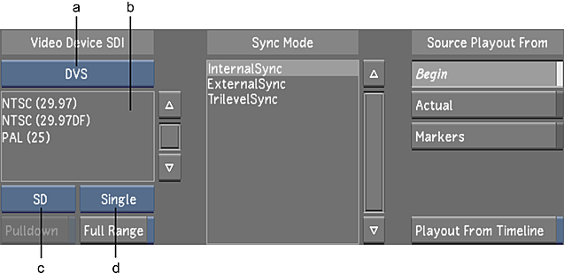

Use the Playout menu to play out media to a VTR.
The following two graphics represent the Playout menu.

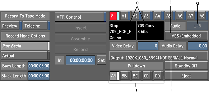

(a) Video/Graphics Raster option box (b) Raster list (c) Format option box (d) Link Type option box (e) VTR Status panel (f) Audio Output status (g) Audio Track Selection option box (h) Pulldown Field buttons (i)
Playout Error status
In order to play out to VTR, you must enable the VTR Control button in the Editing / Playout menu.
- Video/Graphics option box
- Toggle between the video card (AVIO) and the graphics card (GFX/SDI). The Raster list is then populated with rasters for the selected card.
- Raster list
- With a video card selected in the Video option box (AVIO), select one of the listed rasters to set the resolution and timing for capture.
- Format option box
- Toggle to display only rasters belonging to a particular footage format in the Raster list.
| Select:
To display:
| SD
Standard definition rasters.
| HD
High-definition rasters.
| Film
Film rasters.
| Audio
Audio rasters (only applicable to GFX/SDI).
- Link Type option box
- Toggle to display only rasters belonging to a particular link type in the Raster list.
| Select:
To display:
| Single
The single-link (4:2:2 signal) rasters.
| Dual
The dual-link (4:4:4 signal) rasters.
| Stereo
The stereoscopy rasters (only applicable to GFX/SDI).
- Pulldown button
- Enable to configure Lustre to add a pulldown frame when playing out. See
About 3:2 Pulldown.
- Full Range button
- Enable to configure Lustre to play out the full video signal from the video board. If disabled, Lustre plays out only the legal portion of the video signal.
- Sync Mode list
- Select one of the sync modes.

- Source Playout From buttons
- Select a starting point for the playout.
| Enable:
To select:
| Begin
The start of the timeline as the starting point for playing out to tape.
| Actual
The current position of the positioner as the starting point for playing out to tape.
| Markers
The marker position as the starting point for playing out to tape.
- Playout From Timeline button
- When enabled it allows you to play out source material containing secondary grading without having to perform a render first. See
Playout from Timeline with GPU Acceleration.
- Record To Tape Mode buttons
- Allow you to configure Lustre to display what the edited footage would look like without recording to VTR or to play out the current timeline and send the source timecode to the VTR.
| Enable:
To:
| Preview
Preview the footage that will be recorded without recording to tape.
| Telecine
Record the footage to tape along with its original source timecode and black media between shots. See
Writing Telecine-Style Tape.
- Record Mode Options buttons
- Define where on the tape Lustre begins recording when using the Record playout mode. For more information about Record Mode options, see
Playing Out to a VTR.
| Enable:
To begin recording:
| Tape Begin
At the beginning of the tape.
| Actual
At the position of the current frame on the tape.
- Bars Length field
- Defines the duration (in seconds) of the colour bars recorded to the video tape before the recorded footage begins.
- Black Length field
- Defines the duration (in seconds) of the leader black recorded to the video tape before the recorded footage begins.
- Insert button
- Initiates recording when inserting video and/or audio onto a tape that already contains material.
- Assemble button
- Initiates recording of both video and audio signals on all tracks to a tape when you need to record beyond the point where the valid control track ends.
- Record button
- Initiates recording of both video and audio signals on all tracks when recording an entire cut to tape.
Note: Use the Record button to write to a new tape with no content. When you record in Record mode, Lustre writes bars and black media before the playout.
- In Point field
- Enter the timecode of the tape where the recording will begin.
Note: When you configure the in point, the out point is automatically set to the timecode that equals to sum of the clip duration added to the in point.
- In Point Set button
- Sets the current timecode of the tape as the in point.
- V button
- Enable to play out the video track when playing out to a video source. Disable to play out audio only.
- A1 - A16 buttons
- Enable the audio tracks (A1-A16) for playout.
Note: You can only specify specific video and audio tracks to play out if you are in Insert mode.
- VTR Status panel
- Displays VTR status messages when Lustre is connected to a VTR.
- Audio Track Selection option box
- Used in correlation with the A1-A16 buttons. Toggle to determine whether tracks 1-8 or 9-16 are visible. Tracks 9-16 are only available with embedded AJA audio. If only eight audio tracks are available, this option is disabled (greyed out).
- Audio Output status
- Audio is always outputted to both AES and Embedded audio.
- Video Delay field
- Enter a frame number to delay the video playout for that number of fields. For example, if you set the field to 10, playout begins 10 frames after the in point. If you set the field to -10, playout begins 10 frames before the in point.
- Audio Delay field
- Enter a frame number to delay the audio playout for that number of fields. For example, if you set the field to 10, audio playout begins 10 frames after the in point. If you set the field to -10, audio playout begins 10 frames before the in point.
Note: The Video and Audio Delay fields compensate for frame delays that may exist while transferring shots from Lustre to the output device.
- Playout Error status
- Displays a message if an error occurs while performing a playout.
- Pulldown Field buttons
- Enable a Pulldown Field button to select the frame used for the 3:2 pulldown. Only available when Pulldown is enabled. See
About 3:2 Pulldown.
- Standby Off button
- Removes the VTR heads from the tape.
- Eject button
- Ejects the tape in the VTR.
