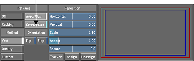

Repositioning is fully supported in a stereoscopic project. When Sync mode is enabled, you can reposition both eyes at the same time. (For example, the image in both eyes are offset horizontally by the same amount.)
You can also correct convergence discrepancies for the Left Eye and Right Eye by repositioning images at the same time in an equal and opposite manner. (For example, if you scale the image in the Left Eye to 0.80, the image in the Right Eye will be scaled to -1.20.)
You can converge two images using the repositioning options of the Autodesk Control Surface. See Repositioning Shots See the Autodesk Control Surface User Guide.
To converge Left Eye and Right Eye images:
