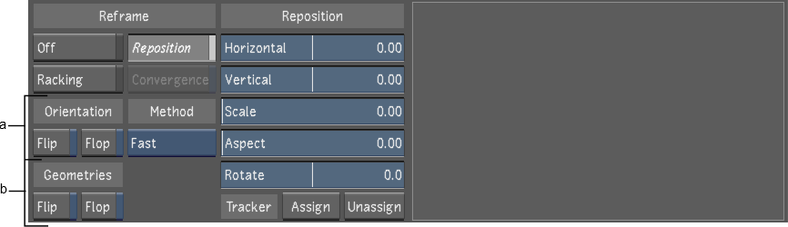

Use the Flip or Flop tool to change your shot's orientation.
| Original Image | Flipped image | Flopped image |
To change the orientation of a shot:
(a) Orientation tools (b) Geometries tools
| Enable: | To: |
| Flip | Apply a horizontal translation to the image. |
| Flop | Apply a vertical translation to the image. |
If you have geometries associated to secondaries, you can apply a horizontal or vertical translation to the geometries, independently of the image's orientation, using the Geometries tools. By default, the geometries will follow the image's orientation.
| Enable: | To: |
| Flip | Apply a horizontal translation to the geometries. |
| Flop | Apply a vertical translation to the geometries. |
