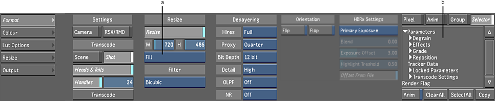

(a) Fit Method option box (b) Selector
Once you change one of the Lustre transcode options, this button is automatically disabled to show that these settings are no longer the original RSX file settings.
