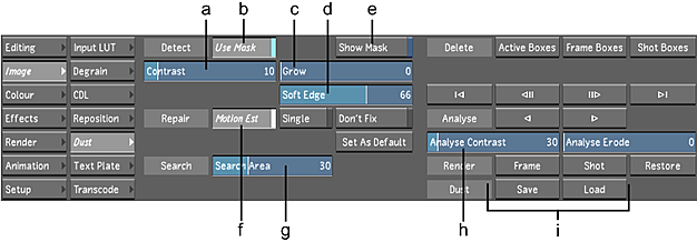

(a) Contrast field (b) Use Mask button (c) Grow field (d) Soft Edge field (e) Show Mask button (f) Motion Estimation button (g) Search Area field (h) Analyse Contrast slider (i) Dust Save and Load buttons
Lustre will create masks for any artefacts it finds inside dust removal boxes, based on the Contrast and Grow parameters.
This repair type uses a motion estimation calculation to identify motion in successive frames.
This parameter controls the size of the area (in pixels) around each pixel in which the motion estimation calculation searches for motion. This enables Lustre to differentiate between motion in the shot and dust artefacts. Estimate the approximate search area required for the amount of motion-caused colour displacement between frames. Set a large area for shots with fast motion, and a small area for shots with slower motion.
Low contrast values cause the algorithm to accept low colour value differences between corresponding pixels on the current, previous, and next frames. Therefore, low values result in more complete removal of the artefact. However, if the contrast is set lower than actually needed, adjacent pixels are modified more than actually required to remove the dust.

Low values result in more complete removal of the artefact. However, if the contrast is set lower than actually needed, adjacent pixels are modified more than actually required to remove the dust. Increase (or decrease) the Contrast value until right before the dust starts to reappear.
The Grow parameter controls the number of pixels around the pixels detected by Lustre. The Soft Edge parameter softens the stroke of the pixels specified by the Grow parameter in order to replicate a natural paint stroke.
