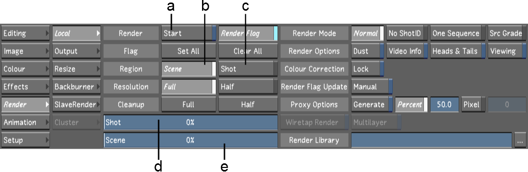

Once you have set all the rendering options, you can render flagged shots within a scene region using the Render Local menu, or just render one shot at a time by enabling the shot region.
To render the selected region:
(a) Start button (b) Region Scene button (c) Region Shot button (d) Shot progress bar (e) Scene progress bar
The render starts and its progress is shown in the Shot and Scene progress bars. The Start button label changes to Stop. When the Shot progress bar reaches 100% and the Render button is no longer highlighted (it again reads “Start”), the render is complete.
