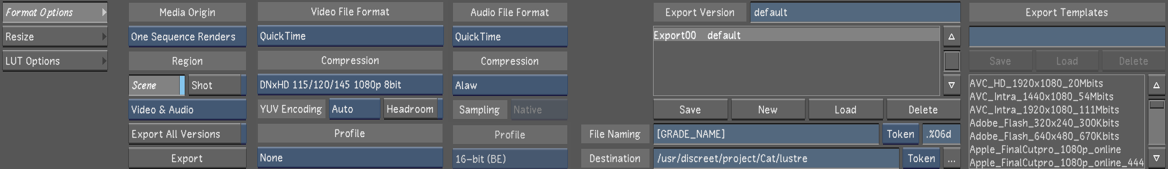

Format Options Tab - Video Settings
Video File Format: Use to select the file type for the export of the video stream.
Compression: Displays the list of available codecs based on the selected Wiretap Gateway server. See Wiretap Gateway Supported Media File Formats for a complete list of supported media file formats.
Note: The list only displays the available codecs that are compatible with the resolution, frame rate and bit depth of the current grade.
YUV Encoding
The YUV Encoding box allows you to select the YUV colour space to use when exporting the clip. Because Lustre works in the RGB colour space, it needs to translate RGB information into YUV . This setting ensures that the right decoder is used for this. The Auto setting selects the colour decoder based on the resolution of the clip. Options are:
  • Auto
  • Rec601
  • Rec709
  • Rec2020
The Auto option uses Rec601 for standard definition clips and Rec709 for everything else. Specifying the wrong colour space results in colours that are off.
Headroom
Enable to include YUV headroom on export for Quicktime and MXF files.
Profile: You can select a pre defined profile for certain video file formats. Selecting a profile populates all the relevant parameters for the export.
