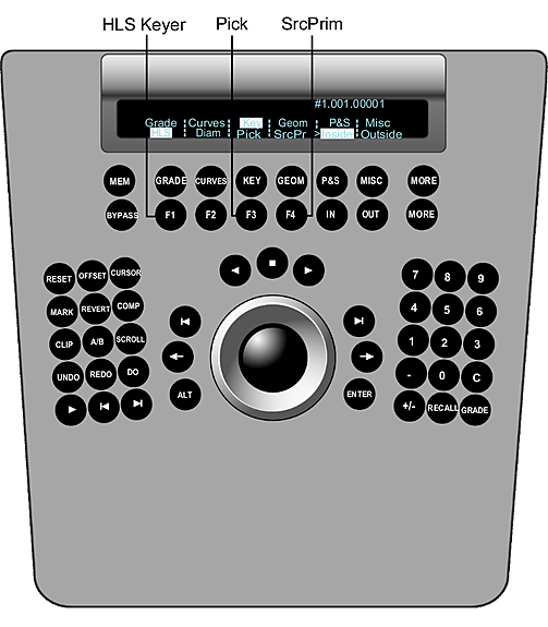

Use the Navigation panel to:
Use the Function panel to adjust the key by setting softness and tolerance ranges, modify key edges, invert the key, and link layers.
To enable the HLS Keyer in the Navigation panel:
The HLS Keyer and Inside are enabled.
To select a secondary layer in the Navigation panel:
To sample the image in the Navigation panel:
To extract a key in the Navigation panel:

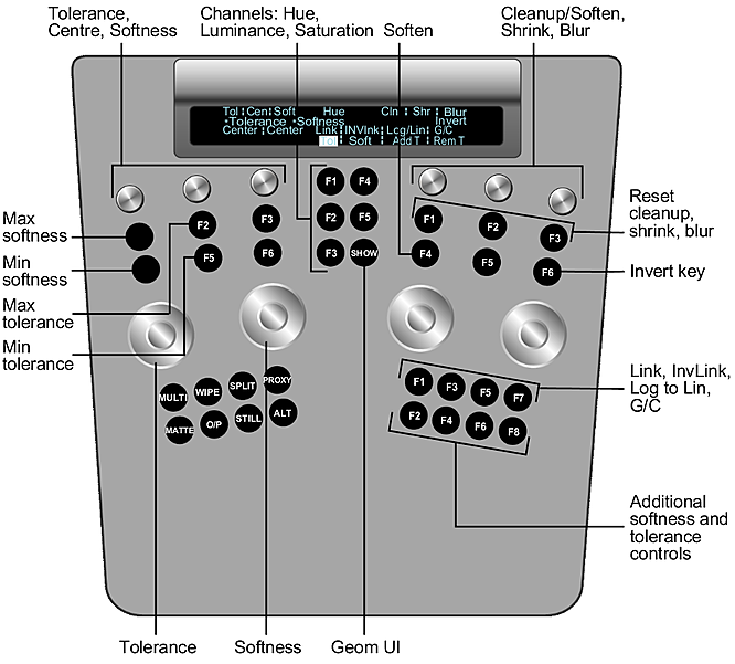

To adjust a key in the Function panel:
| Use: | To: |
| Wheels | Adjust the tolerance and softness around the picked colour. Wheel 1=Tolerance Wheel 2=Softness |
| Knobs at top left | Adjust minimum/maximum tolerance, centre tolerance, and minimum/maximum softness. Knob 1=Minimum/maximum tolerance Knob 2=Centre Knob 3=Minimum/maximum softness |
| Upper left F1 and F4 buttons | Enable either minimum or maximum tolerance (Knob 1) adjustments. F1=Minimum F4=Maximum |
| Upper left F3 and F6 buttons | Enable either minimum or maximum softness (Knob 3) adjustments. F3=Minimum F6=Maximum |
| Buttons in centre column | Adjust tolerance, centre, and softness values separately for each of the channels forming the basis of the key. F1=Hue F2=Luminance F3=Saturation |
| Knobs at top right | Modify key edges and remove stray pixels from a key. Knob 4=Cleanup Knob 5=Shrink Knob 6=Blur |
| Buttons at top right |
Press F1 to enable cleanup (Key-out), shrink, and blur. Press F4 to enable soften (Key-in filter). F1=Cleanup F2=Shrink F3=Blur F4=Soften Single press F2 and F3 to reset shrink and blur, respectively. Double-press F1 and F4 to reset cleanup and soften, respectively. |
| Upper right F6 button | Invert the key. |
| First row of buttons at bottom right |
Press F1 to cycle through add, intersect, subtract, or link layers. F1=Add, intersect, subtract, or link F3=Invert link F5=Log to Lin F7=GPU compatibility |
| Second row of buttons at bottom right | Add or subtract tolerance and softness from the key. F2=Tolerance F4=Softness F6=Add softness/tolerance F8=Subtract softness/tolerance Press F3 on the Navigation panel to change the cursor into a picker prior to using any of the above buttons. When done defining tolerance and softness, press F3 again. |
| SHOW button | Toggle the geometry wireframe on or off. |
