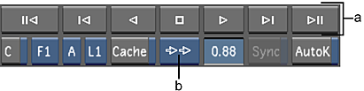

To play shots in a cut:
(a) Playback controls (b) Play Mode button
| Select: | To specify a looped playback range: |
Of the entire timeline. |
Of the current shot. |
Between in and out points. |

| Click: | Or press: | To: |
Right Ctrl during playback | Play the cut forward. |
Right Alt during playback | Play the cut backward. |
N/A | Stop playback. |
| N/A | Spacebar | Start or stop playback in the direction last played. |
When playback is stopped, the Right Alt and Right Ctrl keyboard shortcuts are used for backward and forward frame navigation, as in previous releases.
