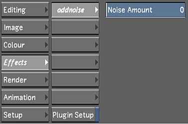

Add Noise
Grain-type plugin that you can use for adding random noise to an image. Use the Noise Amount parameter to adjust the amount of noise added to the shot.

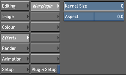

Blur
Simple blur plugin using a high-speed algorithm.
Use: To:
Kernel Size Adjust the amount of blur.
Aspect Adjust the orientation of the blur. A negative value produces a horizontal blur and a positive value produces a vertical blur.

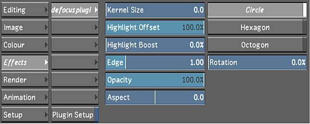

Defocus
Blur-type plugin that simulates a camera out-of-focus effect. Along with the blur parameters, this plugin includes variable iris types, additional highlight controls, as well as a control for softening the edge of a secondary.
Use: To:
Kernel Size Set the amount of the camera defocus.
Highlight Offset Offset the highlight range.
Highlight Boost Increase the highlight range.
Edge Adjust the edge softness of a matte when using this plugin with a secondary.
Opacity Change the opacity of the image. By adding transparency, you see through to the original image.
Circle, Hexagon, Octagon Specify the shape of the plugin matrix (or camera iris) used to calculate how the defocus is applied.
Rotation Rotate the plugin matrix (or iris).

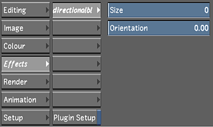

Directional Blur
Simple directional blur along a specified direction.
Use: To:
Orientation Change the direction of the blur.

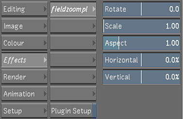

Field Zoom
Pan, scan, scale, and rotate interlaced footage. The parameters in this plugin work in the same way as the tools in the Image > Reposition menu, except that they are applied to individual fields instead of the entire frame. This yields a smooth image from interlaced footage even after repositioning.
Use: To:
Rotate Rotate the fields.
Scale Resize the fields.
Aspect Adjust the aspect ratio of the fields.
Horizontal Adjust the horizontal position of the fields.
Vertical Adjust the vertical position of the fields.

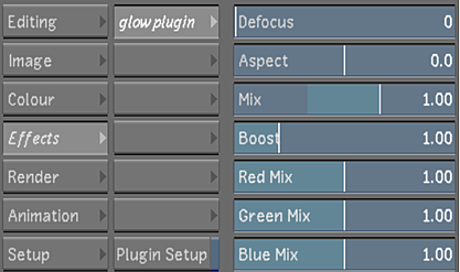

Glow
Blur-type plugin that can be used by itself or combined with a secondary key.
Use: To:
Defocus Adjust the amount of blur.
Mix Adjust the amount of mix between the original image and the blurred image.
Boost Multiply key values when using the plugin on a secondary key. This allows you to visually grow your key by increasing the range of the key value.
Red Mix Adjust the red gain of the blurred image.
Green Mix Adjust the green gain of the blurred image.
Blue Mix Adjust the blue gain of the blurred image.

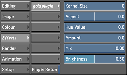

Gold
Blur-type effect that allows you to soften and tint an image. The defocused and coloured image is multiplicatively combined with the original image to create a coloured soft-filter look.
Use: To:
Hue Value Set the hue that is used to tint the image.
Amount Adjust the amount of the selected hue.
Mix Adjust the amount of mix between the original image and the blurred, tinted image. The other parameters have no effect until you set the Mix value.
Brightness Adjust the brightness of the tinted image.

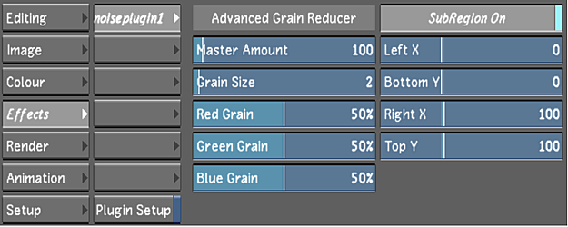

Noise Plugin 1
This grain-type plugin is a first generation advanced noise reducer that uses a spatial filter with detail preservation control. It is useful for grain, noise, or detail reduction. During playback, this plugin updates dynamically as you adjust the values, so you can see how the grain removal works in context of the shot.
If the plugin processing slows down image playback, you can restrict grain reduction to a subregion of the frame.
Use: To:
Master Amount Set how much the grain is reduced. The default value (or less) generally produces a good result for grain removal.
Grain Size Set the size of grain that is reduced.
Red Grain Independently adjust grain removal on the red colour channel.
Green Grain Independently adjust grain removal on the green colour channel.
Blue Grain Independently adjust grain removal on the blue colour channel.
SubRegion On
Restrict the grain setting to the subregion defined by the bounding box.
Right-click in the subregion to drag it to another position.
Adjust the size of the subregion by clicking and dragging a corner of the subregion bounding box.
Left X, Bottom Y, Right X, Top Y You can adjust the size of the subregion bounding box by adjusting these parameters.

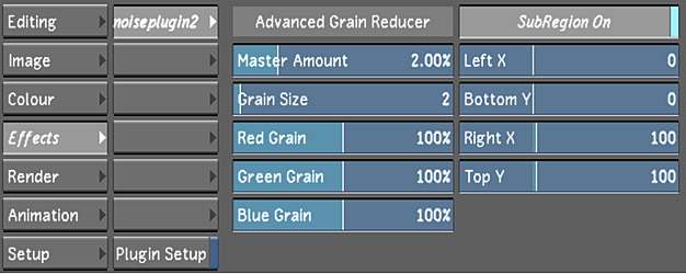

Noise Plugin 2
This grain-type plugin is a second generation advanced noise reducer that uses a spatial filter with detail preservation control. It is useful for grain, noise, or detail reduction. During playback, this plugin updates dynamically as you adjust the values, so you can see how the grain removal works in context of the shot.
Use: To:
SubRegion On

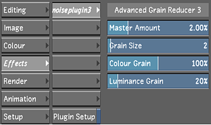

Noise Plugin 3
This grain-type plugin is a third generation advanced noise reducer that uses a spatial filter with detail preservation control. You can control luminance and colour noise processing separately.
Use: To:
Colour Grain Adjust grain reduction on colour grain only.
Luminance Grain Adjust grain reduction on luminance grain only.

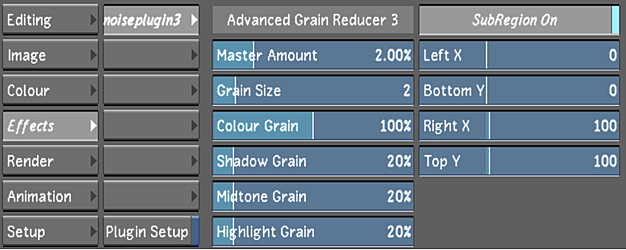

Noise Plugin 3.1
This grain-type plugin is a third generation advanced noise reducer that uses a spatial filter with detail preservation control. It is useful for colour noise processing, and allows you to specify whether processing should occur in the shadows, midtones, or highlights. During playback, this plugin updates dynamically as you adjust the values, so you can see how the grain removal works in context of the shot. It is the fastest of the four noise plugins available in Lustre.
Use: To:
Shadow Grain Adjust grain reduction in the shadows only.
Midtone Grain Adjust grain reduction in the midtones only.
Highlight Grain Adjust grain reduction in the highlights only.
SubRegion On

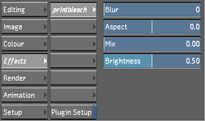

Print Bleach
Blur-type plugin that creates an effect similar to the chemical print bleach process. This plugin increases contrast for the shadows while desaturating the image. When you use this plugin, you first set a mix value so that you mix the image onto itself, and then you blur and brighten the underlying layer.
Use: To:
Blur Adjust the amount of blur. The blur parameter has no effect until you set the mix parameter.
Mix Change the amount of the mix. By increasing the mix value, you increase the contrast and decrease the saturation of the image.
Brightness Adjust the amount of brightness of the blurred image. The brightness parameter has no effect until you set the mix parameter.

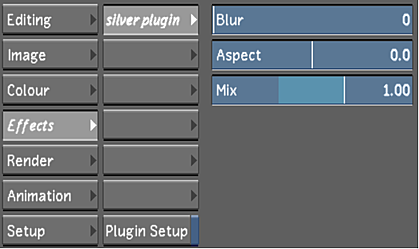

Silver
Blur-type effect that mixes a black-and-white (desaturated) image with the original image creating a soft-filtered look.
Use: To:
Mix Adjust how much the black and white image is mixed with the original. Use a negative value to give your image a silver look.
