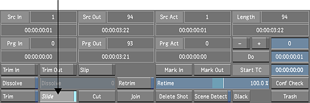

To slide a cut point:
In Slide mode, you see the outgoing frame before the cut in the left viewer and the incoming frame after the cut in the right viewer.
If both clips have available handles, drag to the left or right to move the cut point.
Frames are added to one side of the cut and subtracted from the other to keep the total timeline duration the same. When you run out of handles, you can no longer continue sliding in the same direction.
The timeline is updated when you exit Slide mode.
