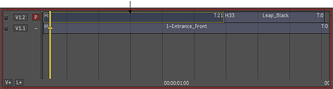

Inside a container you can work with video tracks and layers:

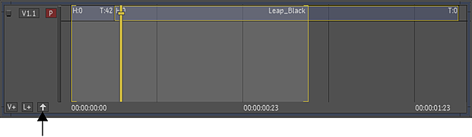

To exit a container:
The contents of the container are collapsed into a single segment.

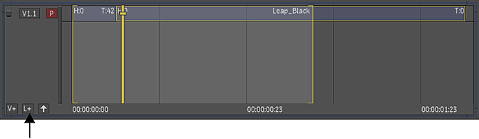

To add a clip to a layer in a container:
Use containers to hold multiple versions of grading on a shot.
To create a new version of the grading without entering the container:
A new version on vertical layer appears inside the container.
