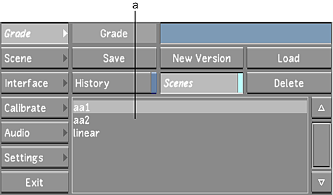

To select a scene in the Grade menu:
The Grade menu appears.
(a) Scene list
A list of scenes created in the current project appears.
It is highlighted in grey, indicating it is the selected scene.
