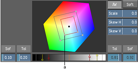

To set the chrominance range for tolerance by moving and modifying the Tolerance Diamond:
In Secondary view, you can see the effect of the modifications you make to the chrominance range for tolerance while you fine-tune the key.
(a) Tolerance Diamond vertex
The chrominance range for tolerance is modified.

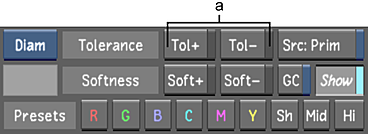

To set the luminance levels and chrominance range for tolerance using the Add/Remove Tolerance buttons:
(a) Add Tolerance and Remove Tolerance buttons
The chrominance range and luminance levels for tolerance are modified.

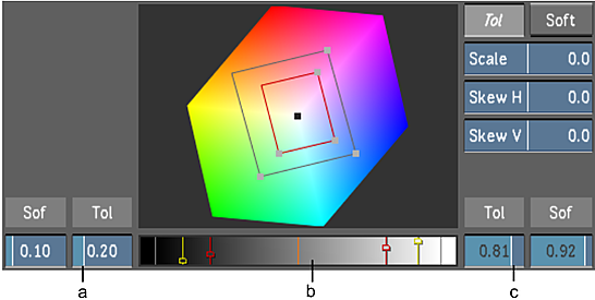

To set the luminance levels for tolerance using the Minimum and Maximum Luminance sliders:
In Matte view, you can see the effect of the modifications you make to the luminance levels for tolerance while you fine-tune the key.
(a) Minimum Luminance slider for tolerance (b) Luminance gradient (c) Maximum Luminance slider for tolerance
The luminance levels for tolerance are modified.
