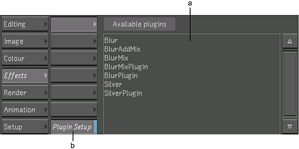

To create animations in the Effects menu:
Click Effects, and then enable Plugin Setup.
(a) Available plugins list (b) Plugin Setup button
The Available plugins list appears.

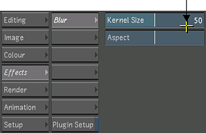

A keyframe is added at the current frame. When adding keyframes in this way, the interpolation type is always set to Bezier. To change it, you have to use the Interpolation controls in the Animation menu.
