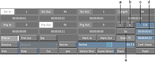

To trim frames at the in point for one or more selected shots:

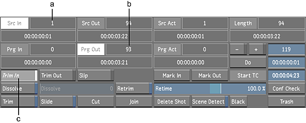

The Edit menu appears.
(a) Src In field (b) Prg Out field (c) Trim In button
Src In and Prg Out are highlighted because these values are changed by the Trim In operation.
(a) - (minus) button (b) + (plus) button (c) Frame field (d) Do field (e) Do button
The specified number of frames is added to or subtracted from the shot(s). The Length field is updated to display the number of frames now used.

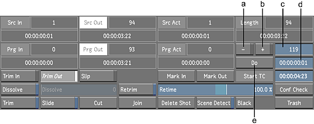

To trim frames at the out point for one or more selected shots:

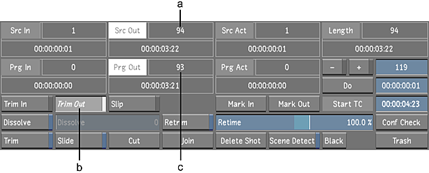

(a) Src Out field (b) Trim Out button (c) Prg Out field
Src Out and Prg Out are highlighted because these values are changed by the Trim Out operation.
The specified number of frames are added to or subtracted from the shot(s). The Length field is updated to display the number of frames now used in the shot.
