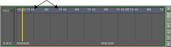

The following image is a C-mode sort using the EDL option with heads and tails enabled. The heads and tails are showing 0 (zero), so you can work on every single frame within the shot.

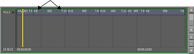

This image shows the timeline being sorted by the C-mode EDL option and the heads and tails are disabled.
