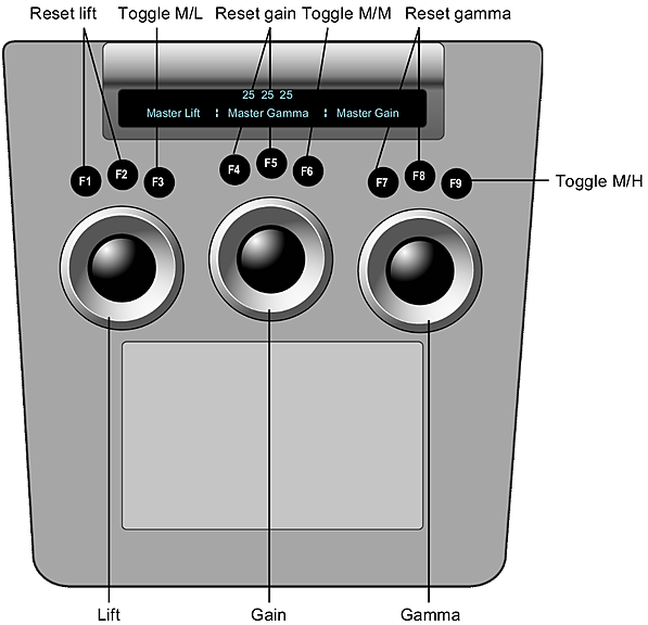

When Lin is enabled in the Setup Grade menu, the Colour Grading panel and the Function panel are activated with linear colour grading functionality.
Use the Colour Grading panel to modify lift, gain, and gamma in the low, mid, and high levels of the image, or across the entire image.
To colour grade in Linear mode using the Colour Grading panel:
| Use: | To: |
| First ring | Modify lift in the overall image. To reset, press the F1 button. |
| First jog ball | Modify lift in a range of colours. To reset, press the F2 button. |
| Second ring | Modify gain in the overall image. To reset, press the F4 button. |
| Second jog ball | Modify gain in a range of colours. To reset, press the F5 button. |
| Third ring | Modify gamma in the overall image. To reset, press the F7 button. |
| Third jog ball | Modify gamma in a range of colours. To reset, press the F8 button. |
| F3 button | Toggle between Master and Low levels. |
| F6 button | Toggle between Master and Mid levels. |
| F9 button | Toggle between Master and High levels. |

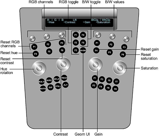

When the Grade menu is enabled, you can use the Function panel to:
To colour grade in Linear mode using the Function panel:
The In Primary, Out Primary, Inside, and Outside options are activated.
| Use: | To: |
| Wheels | Modify overall hue, contrast, gain, and saturation. Wheel 1=Hue Wheel 2=Contrast Wheel 3=Gain Wheel 4=Saturation To reset a wheel, press the button above it. |
| Knobs at top left | Balance the RGB channels. Knob 1=Red Knob 2=Green Knob 3=Blue To reset a knob, press the button below it. |
| Buttons in left centre column | Toggle the type of value to be adjusted in the RGB channels (Knobs 1-3). F1=Lift F2=Gamma F3=Gain |
| Knobs at top right | Define values to clamp minimum and maximum luminance. Knob 4=Black Knob 5=White |
| Buttons in right centre column | Toggle the type of black and white values to be adjusted (Knobs 4-5). F4=Clip F5=Reference |
| SHOW button | Toggle the geometry wireframe on or off. |
