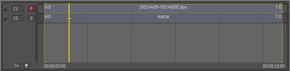

Here are some examples of media structures that Lustre uses for automatic Multi-Channel clip creation with a single matte.
The resulting clip in Lustre displays as a Multi-Channel clip that has a matte channel spanning all the frames of the source clip.
The resulting clip in Lustre displays as a Multi-Channel clip that has a matte channel spanning frames 40 to 55. The matte channel still covers the entire duration of the source clip but secondary grading is not visible on the portions of the clip where there is no matte media even if the RGBA Matte buttons are enabled.
